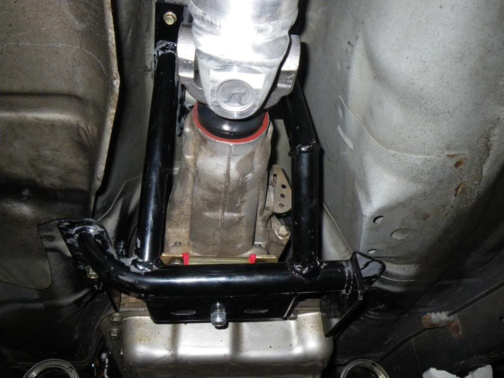

Thanks, I love the navan bumper, I wish the sides were more available/affordable. I have a set of kouki sides, just haven't had the time to put them on. As for the guy on the bike, it was absurd to watch. All I could think was that he was gonna land on the S2000's fender or hood. He didn't seem phased by the landing though.
As for my car, I took apart the trans mount so I could redo it, and just finished putting it back together. I've gotta fix my camaro so I can sell it, and I don't feel like changing lower intake manifolds out in the driveway. So, nissan had to come out of the garage. All of this is so I can make room for a new-to-me '03 WRX I'm buying off a co-worker for very cheap. It needs some maintenance done to it, but otherwise is in great shape.
